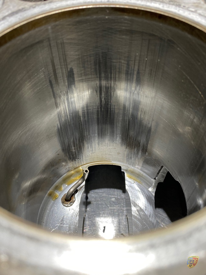

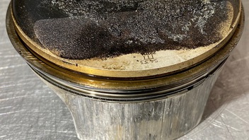

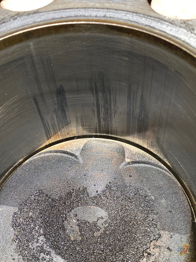

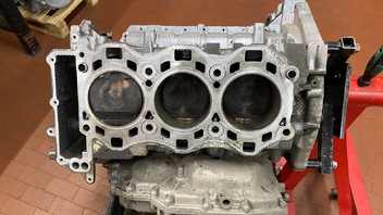

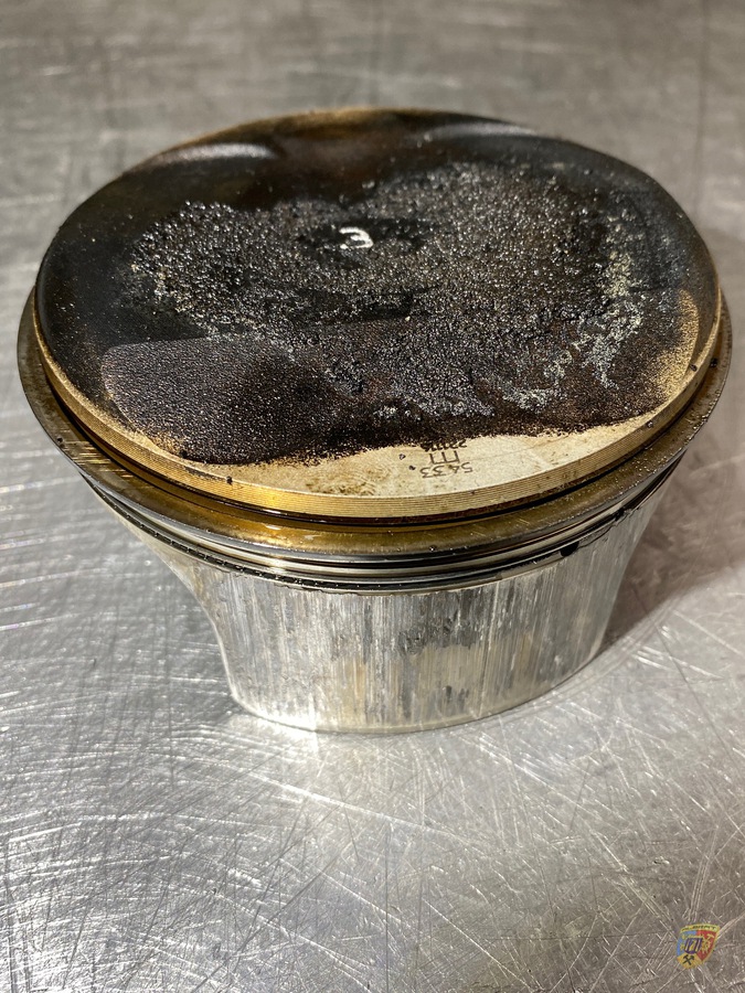

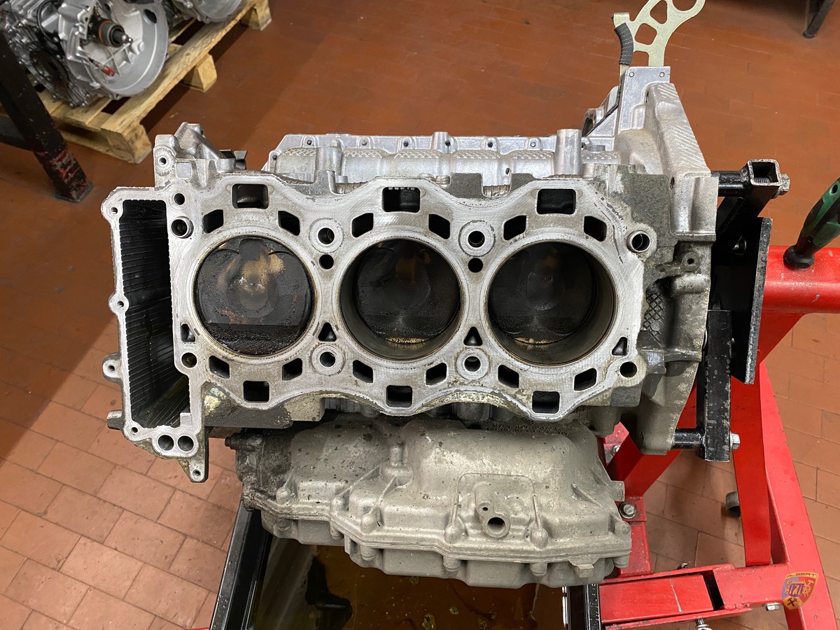

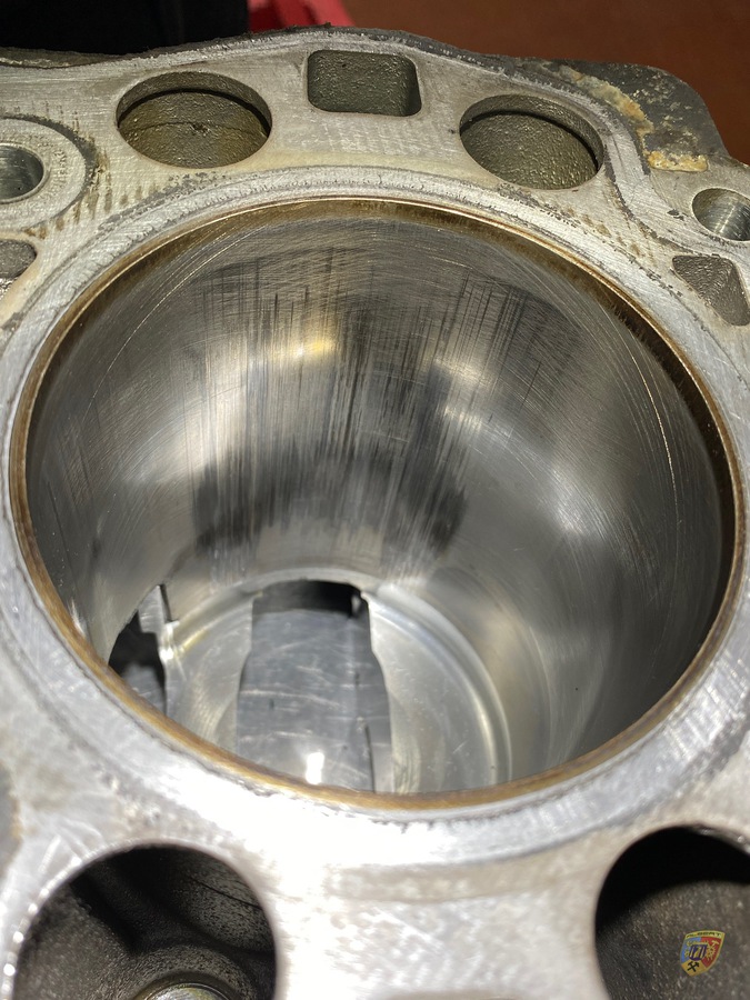

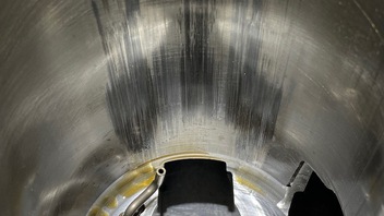

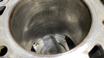

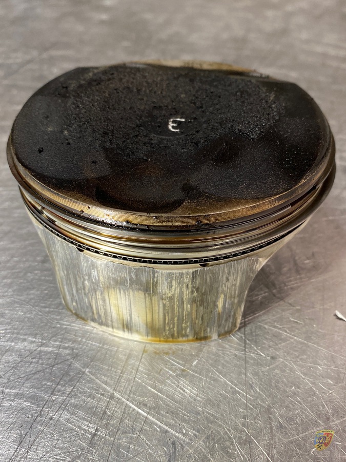

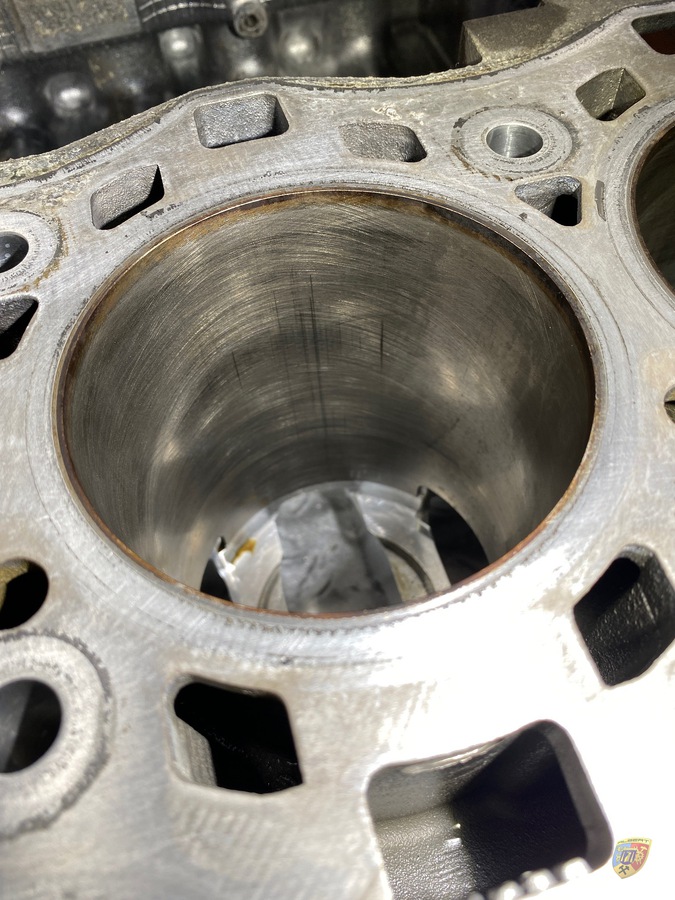

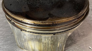

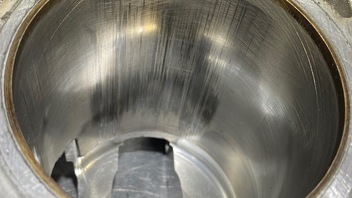

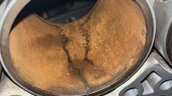

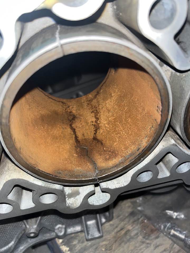

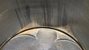

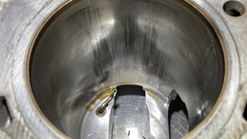

What happened?
The customer drove the car on the freeway, after which the rattling noise was heard. A rattling noise in the engine is usually a sign of mechanical damage, in this case it is piston seizure on all cylinders.
Piston seizures happen in amateurishly repaired engines when either the lubrication is too low, the thermal expansion of the pistons / cylinders was calculated incorrectly, so that the pistons simply jam inside the cylinders during operation and then break, or the cylinders are exposed to the heat not be able to dissipate to the block or the water fast enough not to block the engine.
Here we see the result. The wafer-thin steel cylinders without emergency running properties could not dissipate the heat quickly enough, completely deformed and blocked the pistons in the engine in such a way that they seized and then rattled.
The whole debacle is accompanied by a greatly increased oil consumption, with the suction of oil through the crankcase - ventilation and often with leaking cylinder head gaskets and fractures of other components in the engine.
Here, in this case, a new complete revision is required. We will try to get the unstable old pressed-in cylinders out of the block without causing further damage. Then we have to use our cylinder graphite material to make cylinders adapted to the block and then install them in the engine with new, forged pistons and new wearing parts.
