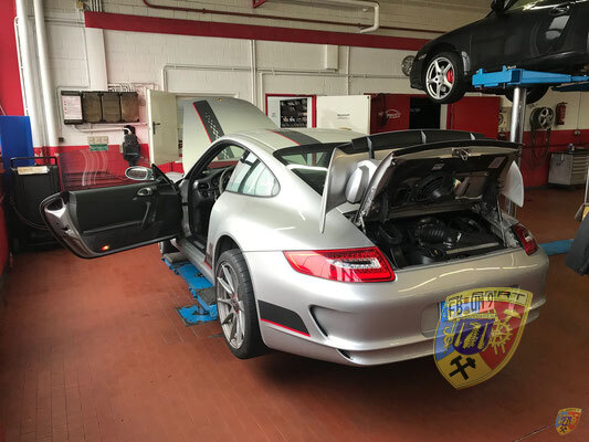

  • It's a long journey through wintry Germany until I finally stand in front of our new customer's house to receive his beautiful Porsche 997 Carrera in GT3 look.
    Our new customer had #researched on the #Internet and then#decided on our #company as a #repair shop for his #vehicle. During the telephone calls in advance, the core of the work to be done was discussed. Below I list the sequence of events #precisely and illustrated, so that our customer and you, dear reader, can find out about the current status of work on the vehicle at any time. If you have any questions about #technical #matters, we are at your disposal.

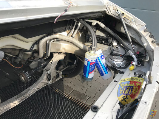

    • Drain all liquids (oil - cooling water - air conditioning etc.)

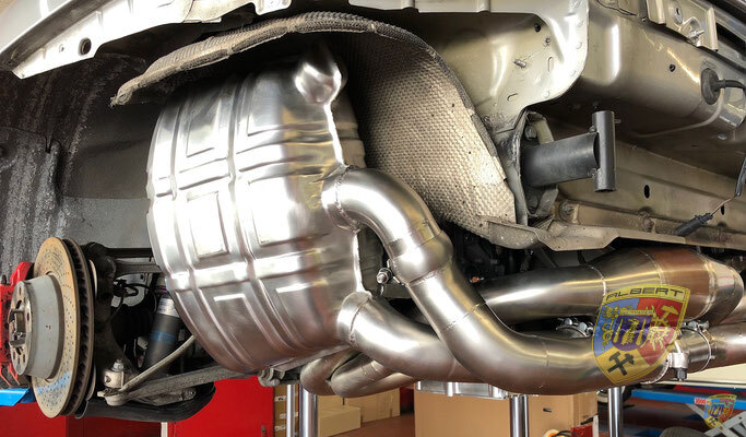

    • Production and #assembly of a #stainless #steel #sports #exhaust #system, analogous to the 997 GT3 RS with center exit.

    • A #center #exhaust made of #stainless steel with pipes with a large cross-section analogous to the 997 GT3 RS is made.

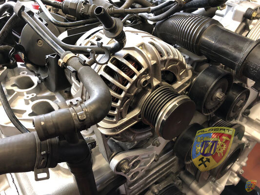

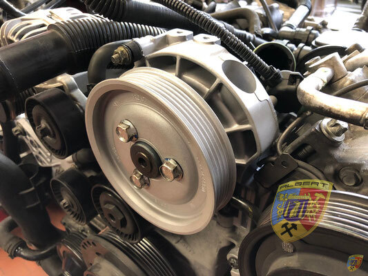

    • Installation of the surrounding motor and control components
    • Installation of the new large intake system with adjustment of all surrounding components
    • Assembly of the engine with preparation for installation
    • Installation of the exhaust bracket and installation of the cat system and fan manifold system

    • 04/05/2018 Arrival of the exhaust system
    • Immediate installation of the exhaust system - test run - leak test etc.
