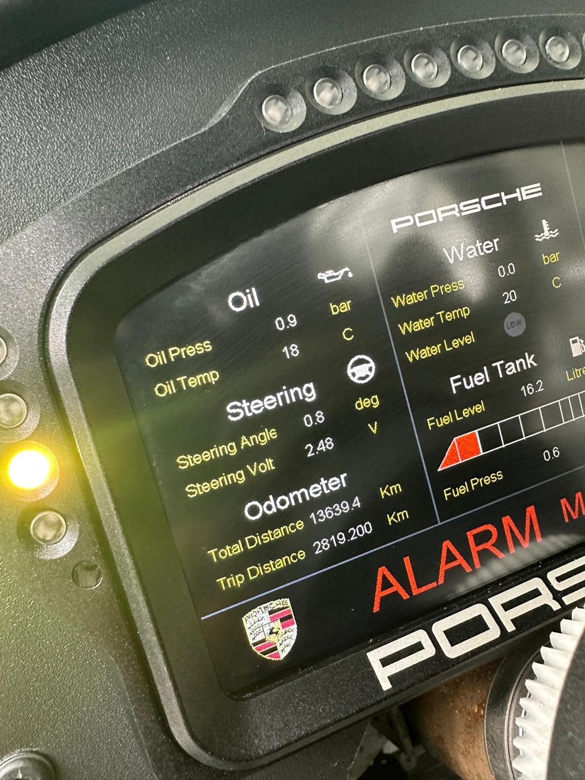

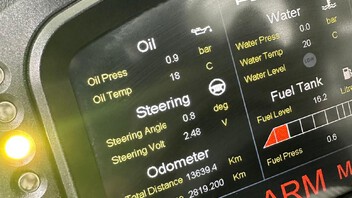

What are the red blocking warning lights on the dash of a 991 Cup for?
Dear All,
Due to current events and as guidance for our Italian customer Igor, here is an explanation regarding the two red warning lights on the left and right of the dashboard in a Porsche 991 GT3 Cup race car.
The locking warning light in the dashboard of a 991 GT3 Cup race car is an indicator that one or more wheels are at risk of locking under braking.
Since the 991 GT3 Cup does not have ABS, hard braking can cause the tires to lock up, especially on cold or uneven surfaces.
The locking warning helps the driver modulate brake pressure accordingly to avoid flat-spotting the tires or losing control.
Typically, this warning is triggered by sensors monitoring wheel speeds. If one wheel spins significantly slower than the others or stops completely, the system detects a risk of locking and alerts the driver.
If the 991 GT3 Cup is equipped with ABS (e.g., via a retrofit ABS kit allowed in some racing series), the locking warning functions slightly differently.
In this case, the warning indicates that ABS is intervening because one or more wheels have reached the locking threshold. This helps the driver optimize braking behavior, such as by modulating pressure more smoothly or adjusting brake force.

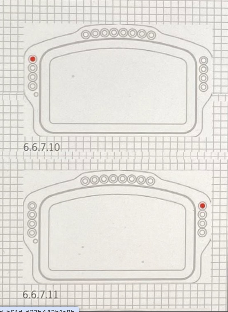

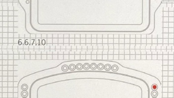

aus aktuellem Anlass und zur Orientierung für unseren italienischen Kunden Igor hier eine Erläuterung
zu den beiden roten Leuchten links und rechts im Dashboard eines Porsche 991 GT3 Cup Rennwagen.
( Und HIER in Italienischer Sprache )
Die Blockierwarnung im Dashboard eines 991 GT3 Cup Rennwagens ist eine Anzeige, die darauf hinweist, dass eines oder mehrere Räder beim Bremsen zu blockieren drohen.
Da der 991 GT3 Cup kein ABS hat, kann es beim harten Bremsen passieren, dass die Reifen blockieren, insbesondere auf kaltem oder unebenen Untergrund.
Die Blockierwarnung hilft dem Fahrer, die Bremskraft entsprechend zu modulieren und einen Bremsplatten (Flat Spot) oder einen Kontrollverlust zu vermeiden.
Typischerweise wird diese Warnung durch Sensoren erfasst, die die Raddrehzahlen überwachen. Falls ein Rad deutlich langsamer als die anderen dreht oder komplett stoppt, erkennt das System eine Blockiergefahr und zeigt dies dem Fahrer an.
Links: Ist der Bremsdruck vorn minimal 10 Bar und die Geschwindigkeit des linken Vorderrades
mindestens 20 km/h kleiner als die des linken Hinterrades, erscheint das linke obere Warnlicht.
Rechts: Ist der Bremsdruck vorn minimal 10 Bar und die Geschwindigkeit des rechten Vorderrades
mindestens 20 km/h kleiner als die des rechten Hinterrades, erscheint das linke obere Warnlicht.
