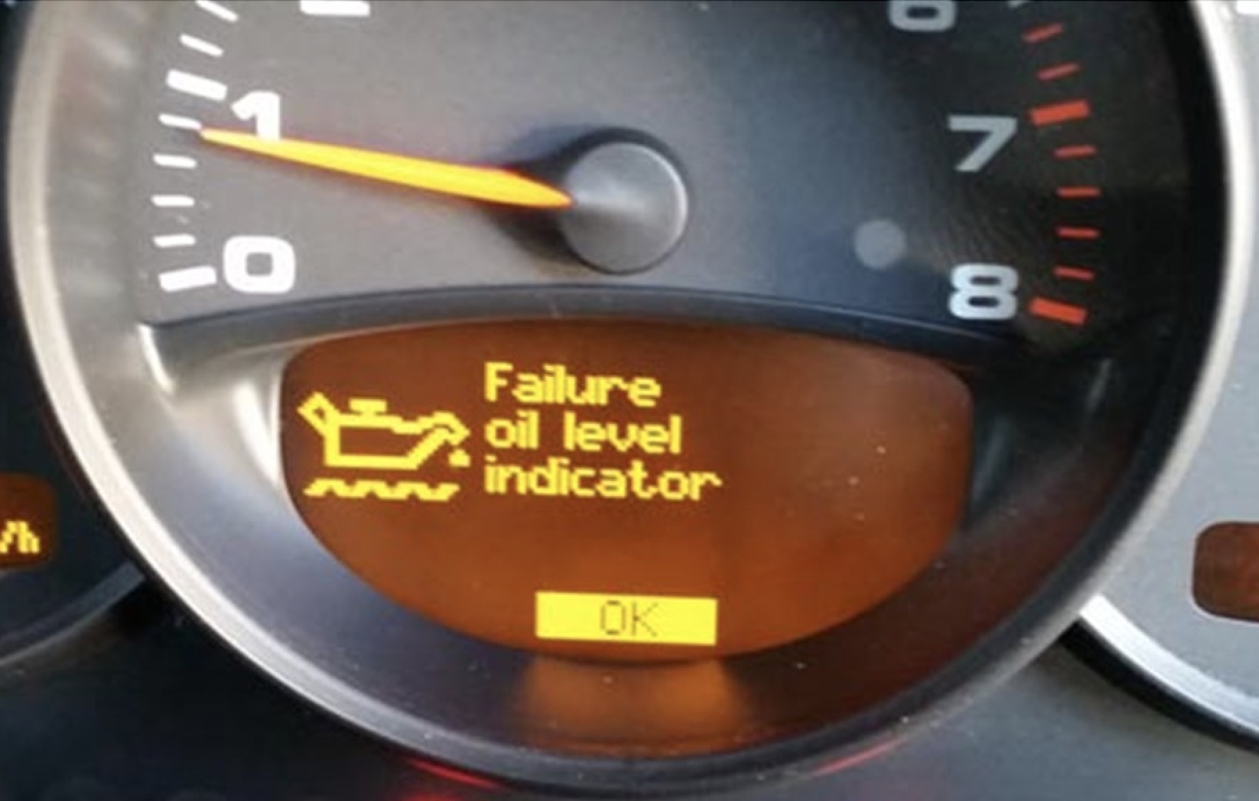

My engine is running now beautiful (thanks for the nice cylinder and pistons I got from you), but now the oil light comes on when the engine is warm and idling. I have tried to get more information about this, but I don't think it does any harm in itself; I just find it annoying that it comes on, and it makes driving less relaxed. My question is, is it bad to keep driving with this, and what is the best thing to do to fix it? I know that the oil pump on an M96 is not the best And sometimes the meter can indicate something different than reality.

Regarding the oil warning light: on the M96 engine it is indeed quite common that, once
the engine is fully warm, the oil pressure at hot idle becomes low enough for the warning
light to flicker or come on slightly. In many cases this is not immediately harmful, especially
if the pressure rises normally as soon as you increase the RPM.
However, the warning light should never simply be ignored completely. The best first step
is to verify the real oil pressure with a mechanical gauge, because the factory sender and
dashboard indication are not always perfectly accurate on these cars.
Things that can influence this are:
- oil viscosity (sometimes a slightly thicker oil helps)
- oil temperature
- condition of the oil pressure sender
- idle speed being slightly too low
- wear in the oil pump or engine bearings
If the engine has good pressure while driving and only drops very low at hot idle, it is usually
not dangerous in the short term. But ideally we should confirm the actual pressure values
before deciding the next step.
A lot of customers improve this behavior by:
- using a high-quality 5W50 or 10W60 oil (depending on climate and usage)
- replacing the oil pressure sender
- slightly increasing idle speed via software if necessary
So my recommendation is:
- Measure the real oil pressure with a mechanical gauge.
- Check the oil sender.
- Then decide whether an oil change or further action is necessary.
As long as the pressure immediately increases with RPM and there are no engine noises,
I would not panic. Have a nice weekend.
