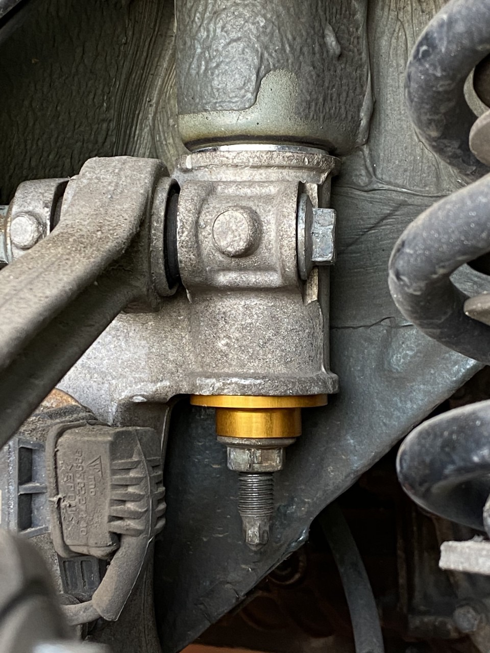

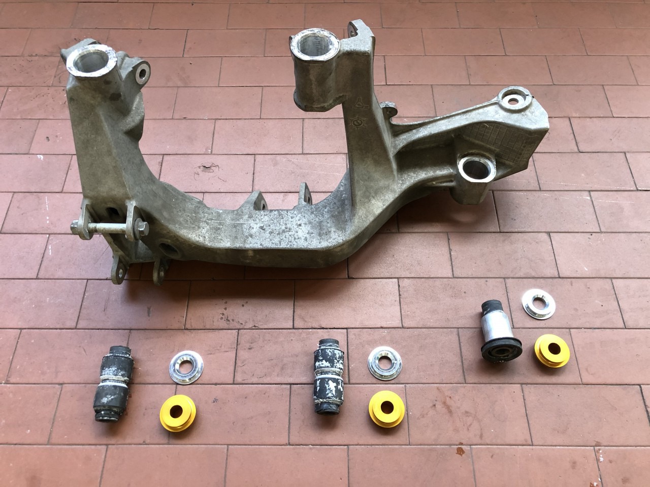

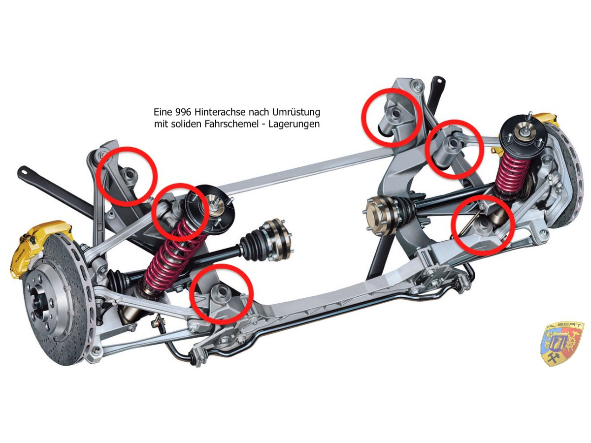

    The problem described results from the #decoupling of the #subframe on the #rear axles of the #Porsche #vehicles.
    This decoupling of the #subframes is carried out at the factory to help normal #Porsche #road vehicles to be #more homogeneous and #quieter in driving. Porsche installs elastic #rubber sleeves and #selent #blocks in order to ban #mechanical #resonances and #vibrations from the #interiors of #vehicles.
    The subframes are attached to the #bodywork. These can now move back and forth slightly due to the #elasticity. Unfortunately, in addition to the #noise reduction, this unfortunately leads to a completely #spongy #driving behavior of your Porsche.
    ?thumbnail=1
    If we now remove this decoupling using our #components, you will hear marginally higher driving noises, you may also hear the transmission and the engine very quietly in the interior, but the road holding improves blatantly!
    Now the subframe is a fixed unit with the body and the chassis. This is also the case with the Porsche #GT3 and #GT2 and #Cup vehicles ex works.
