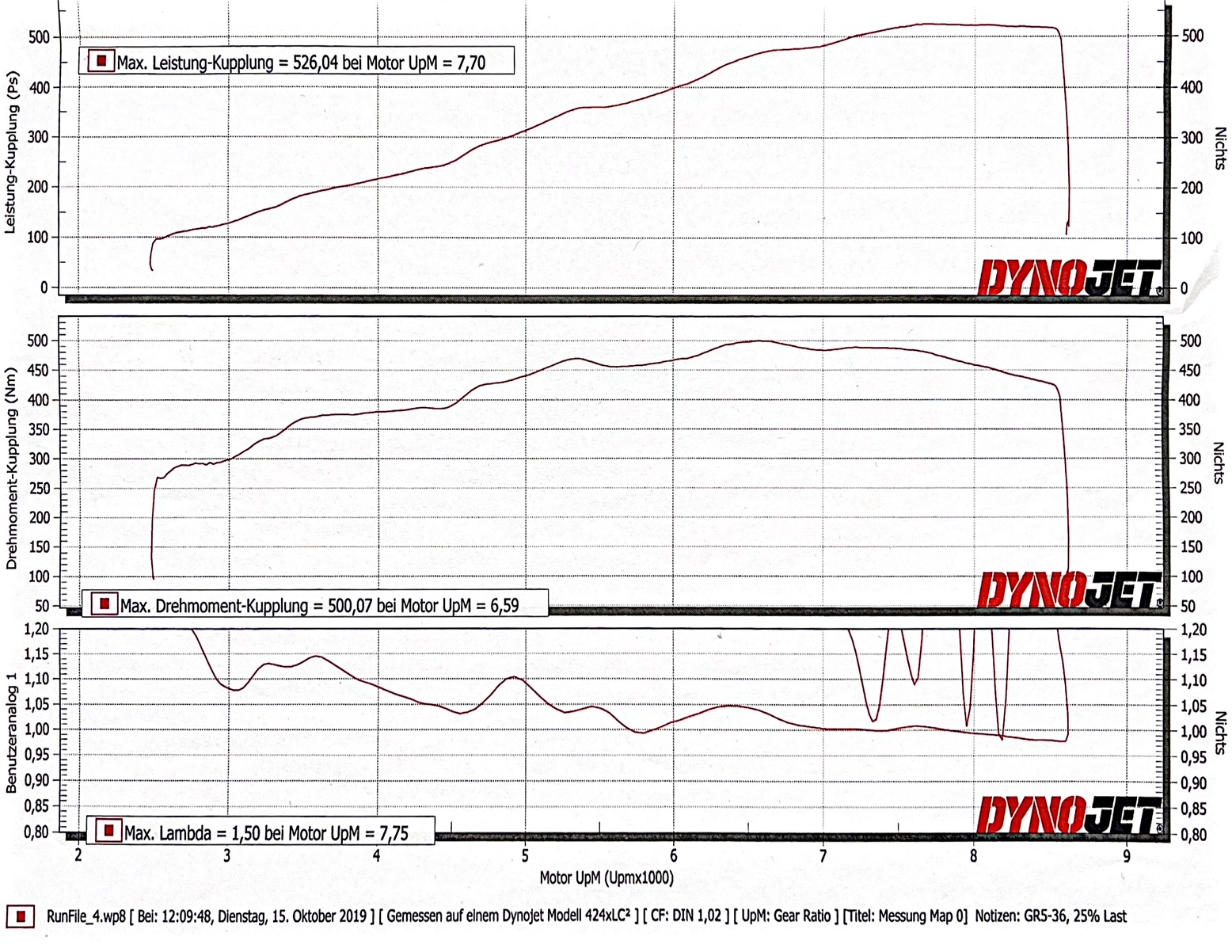

If we now carry out an increase in performance for a customer, as in this case, an increase from 460 hp to around 520 hp, then call we give the customer the measured and already corrected performance of the engine.
This is the power that is transferred from the clutch to the drive train. This engine power is also called #clutch #power.
The data and values of one of our #performance-enhanced Porsche 991
Gen.1 Cup vehicles are given on the attached test bench protocol.
