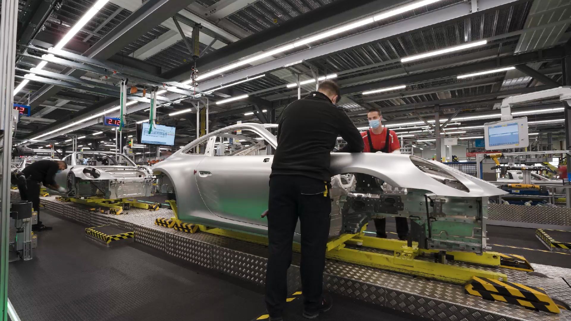

    It is no small feat to craft a 911 –1,500 workers touch each car during its two-day long assembly that starts with a shell and finishes by rolling off a line. Now, for the first time, a time lapse video shows the entire process, focusing on a very special 911 GT3, part of the Paint to Sample program.

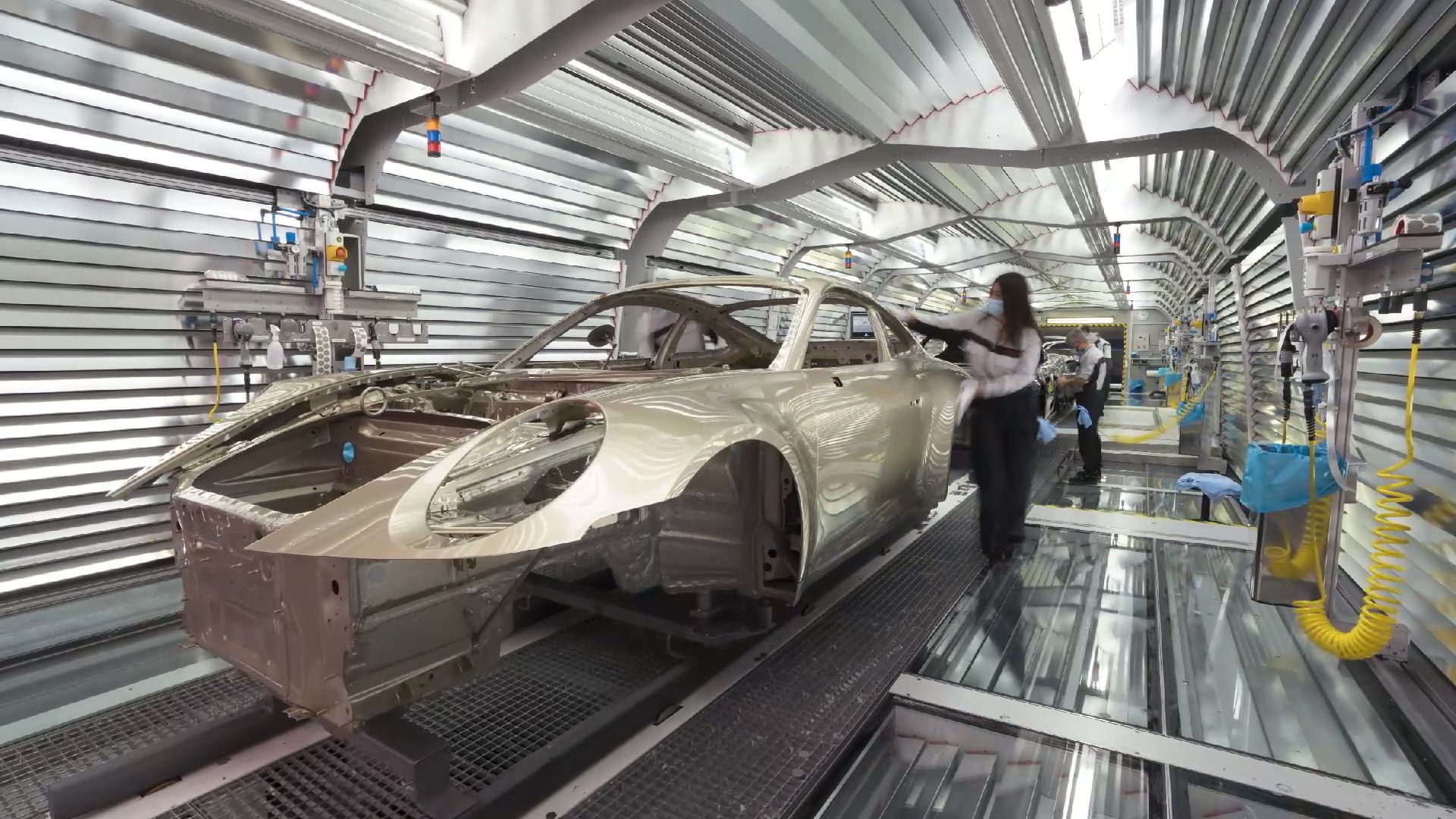

    Prior to its 117-stage assembly, the 911 chassis has spent more than a day going through preparation in the body and paint shop. One of the challenges of painting vehicles and developing paint finishes is working with the material mix of the underlying components. A vehicle body already consists of several different steel and aluminum materials and can also include carbon fiber or polypropylene. Paint batches must suit all exterior features equally and produce the same color.
    Before entering the paint shop, the body is degreased, given a phosphate coat and put through an electro-chemical process chiefly used for corrosion protection. During the coating process, the body is dipped into a basin, which is filled with electrophoretic dip paint and deionized water. To achieve optimal coverage of the body, it is rotated around its own axis in the basin.
    From here a primer, base coat and clear coat are applied to the body and panels, with a standard color using about 4 liters of liquid application between the three stages.
    Primers are chosen based on final color; light colors require light primers, dark colors need dark primer. The base coat is the colored layer which delivers the requested hue and is only up to 30 micrometers thick. To put that into comparison, a standard piece of printer paper is around 100 micrometers.
    The car’s final layer, the clear coat, is its thickest and is sprayed between 30 to 50 micrometers, illustrating just how thin the individual paint coats are. The painted car is then dried at a maximum temperature of 392˚ Fahrenheit (200˚Celcius) for more than two and a half hours.

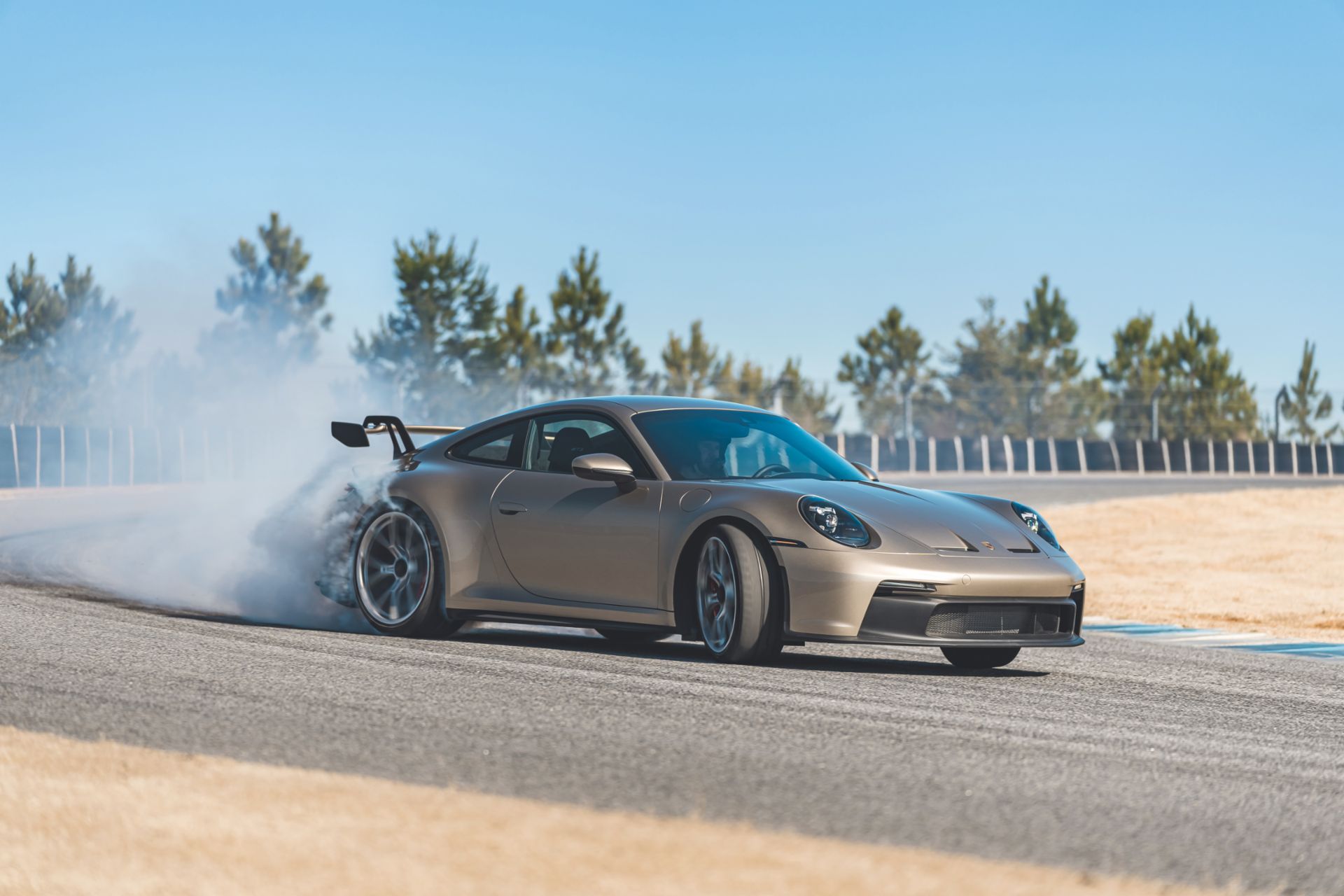

    Leh Keen has done just about everything you can in a Porsche.
    The professional racer takes part in the Porsche Carrera Cup North America one-make series with the 311RS Motorsport team, broke an indoor land speed world record in a Taycan Turbo S, and has built dozens of off-road spec 911 sports cars for fellow thrill seekers through The Keen Project.

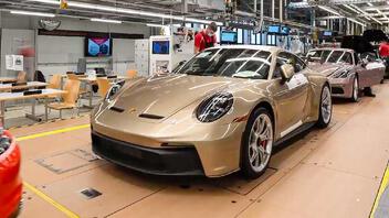

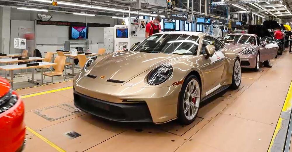

    Until last year, however, he had never ordered a new Porsche from the factory for himself. Keen knew for his 2022 911 GT3 he’d be leaning heavily on the Paint to Sample options.
    “It’s one of my favorite things, I’m obsessed with the different colors,” said Keen. “All these amazing colors that Porsche has done over the years. We really dig deep in the history of Porsche.”
    “I wanted to have this newest, modern 911 but then coated with a very classic old color,” said Keen of the decision. “I told a few people I was going to go gold. People thought it was risky, and it really reinforced my choice and I wanted to see how it would turn out. I think a lot of people couldn’t quite picture the gold in their head.”
    Remembers Keen: “At the dealership when they pulled the cover off of it, I was kind of stunned over how beautiful it was.”
