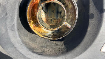

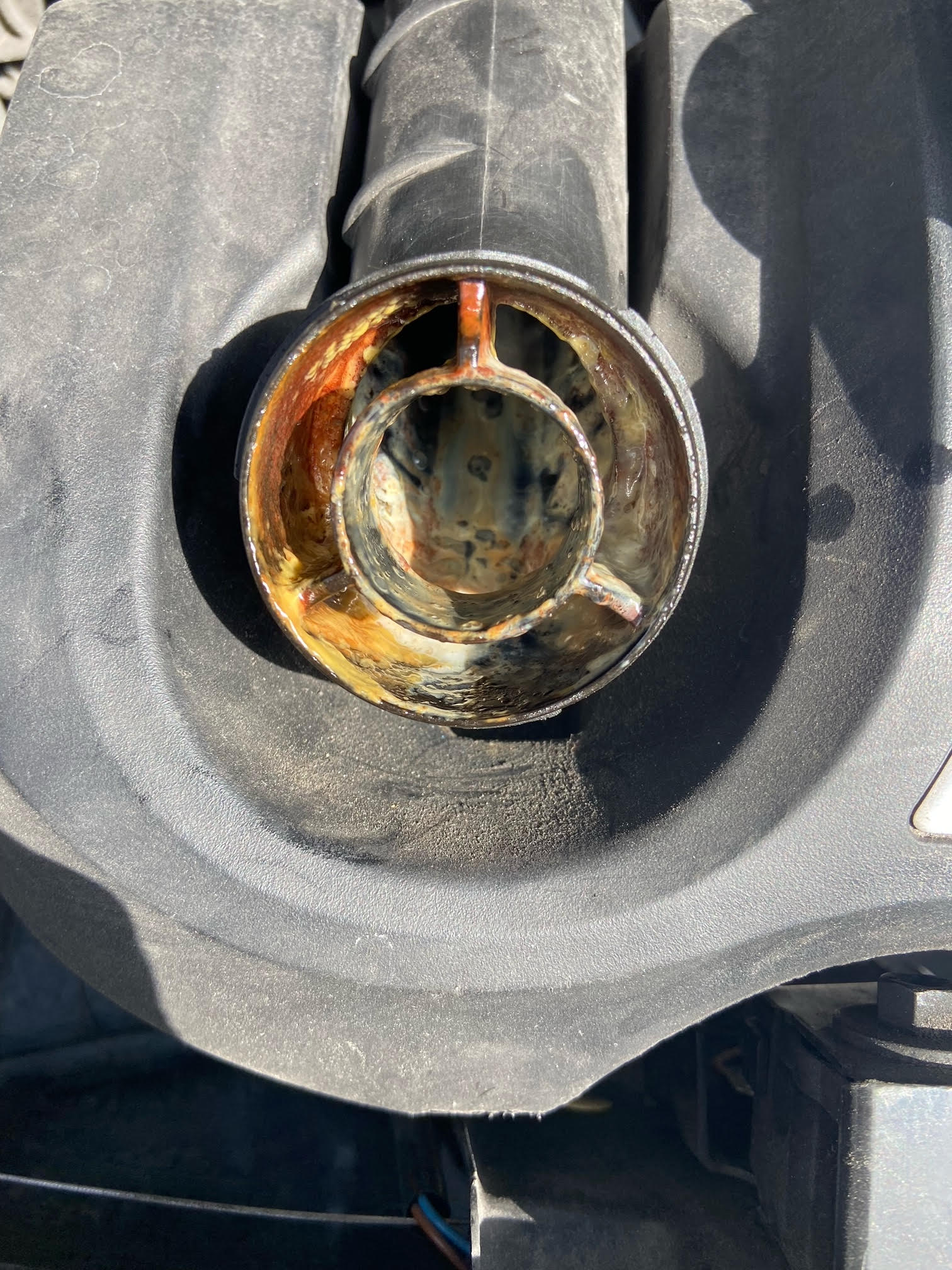

a customer whose engine we completely overhauled in 2017 complained about the heavy oil sludge that he currently found in his oil filler cap. The fear of renewed #engine damage to his #Porsche #997 #Carrera makes him visibly restless, so I'll write us a few lines about it here.
What is that #sludge in the oil and where does this sludge in the oil cap come from?

The harmful components do not evaporate and the #oil sludge formation progresses continuously. The oil filter cover is the furthest from the #center of #heat, or at least the coolest spot on the engine block, so that's where this squishy oil sludge condenses, making our customers uncomfortable.
